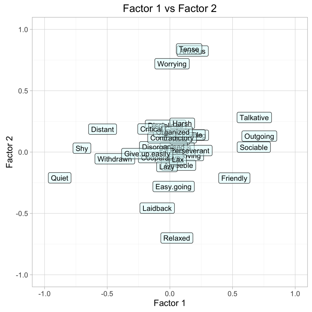

Again, the objective here is: are there a few “factors” that explain personalities well as measured by the 32 personality traits? After varimax rotations on the factors, the factor plots show wonderful results!
To read the graphs, read the personality trait labels at the very extremes of the X and Y axes. These represent the traits with the highest loadings for each factor. The rotated factor plots were surprisingly intuitive to read.
Factor 1 is Introvert/Extrovert. Factor 2 is the propensity to worry, or Anxiety Level.
Factor 3 seems to be Friendliness (or Approachable vs Reserved).
Factor 4 clearly is Organized vs Disorganized.
Factor 5 can be defined as Conscientiousness, or the willingness to be perseverant, to do hard work.
